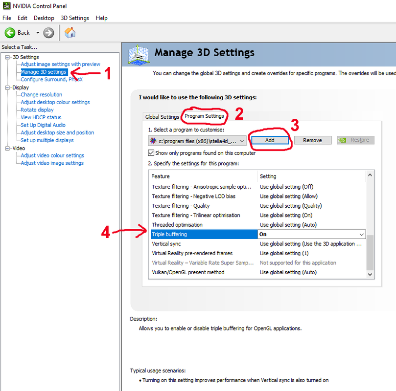

I had this bug too and I think I fixed it the following way (Notebook with Intel and Nvidia grafic card):
right-click on desktop, Nvidia settings, 3d settings, program settings, add Stella4D, triple buffer: on, save settings.
After that all face selects in Stella4D were ok.

Well done Ulrich, if you found a work-around. Here's a screenshot showing the steps, after right-clicking on desktop and selecting "NVIDIA Control Panel".
