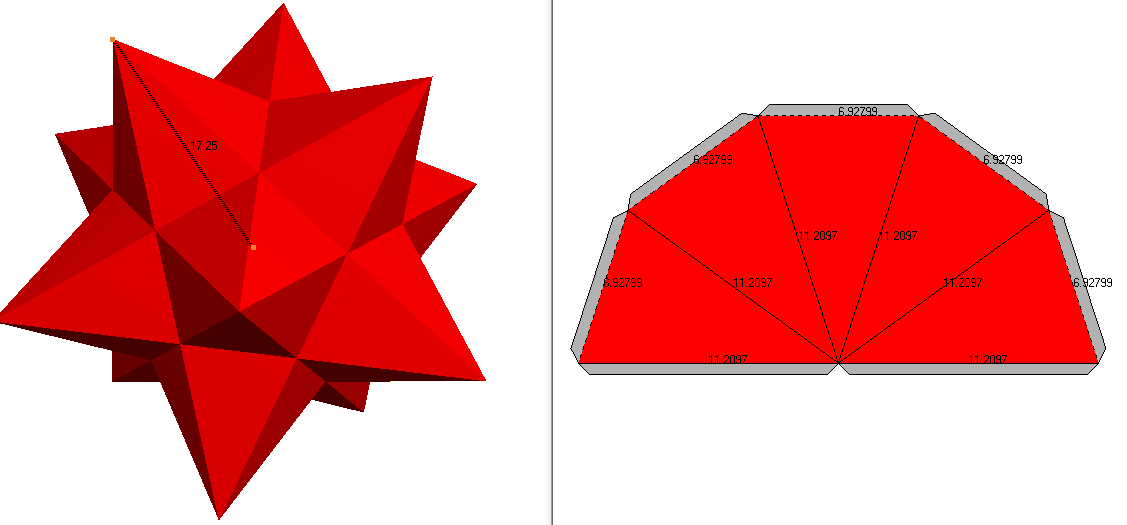

I'm not sure how to do this, however. Using the Shortest Edge Length function in GS requires knowing the ratio between the shortest edge length and the circumradius, something which doesn't seem obvious. I tried using using the Stellation Radius option but I must be misinterpreting the meaning of stellation radius. I was hoping that it would be the same as the circumradius of the stellated polyhedron in the case of a stellation, but the numbers that GS produces do not match the ratios in the figures I have already constructed. For example, in my Small Stellated Dodecahedron, with its 34.5 cm circumradius, the long edge of a a net triangle is 14.7 cm. If I put in 17.25 as the stellation radius, however, GS gives me a net edge length of 11.2. Clearly stellation radius means something other than what I had hoped.

I think you're looking at the wrong thing somehow. If you have the small stellated dodecahedron opened as the base model, then "Base Polyhedron Radius" and "Stellation Radius" (from the Scale menu) will be the same and you can set either. If you have a dodecahedron loaded and go to the SSD as a stellation of it, then "Base Polyhedron Radius" will give the radius of the dodecahedron, which is still the base model, and "Stellation Radius" will give the radius of the current stellation of that base model, in this case the SSD. Your 11.2 figure matches, but I don't know where you got the other figure.

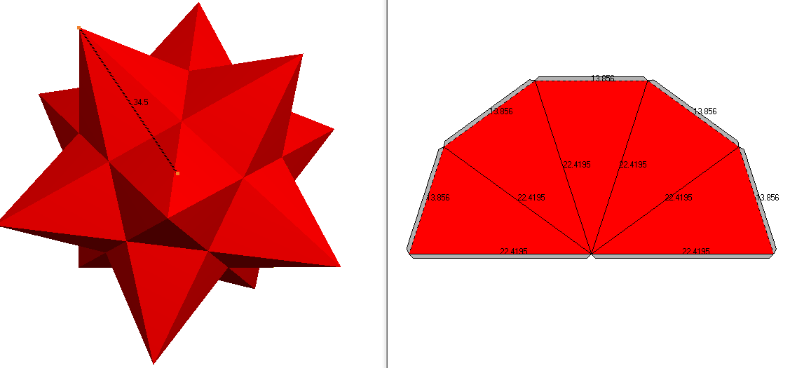

I’ve made two of each of my polyhedra, one for myself and one for my granddaughter, age two. She is fascinated by them and has them hanging from the ceiling in her bedroom. (She refers to all six of them generically as her ‘shapes,’ but knows that this one comes from the dodecahedron. She refers to it as the little dodecahedron star and its counterpart as the big dodecahedron star.) I scaled all of her polyhedra to have a circumradius of 42 cm so that their details would be easily visible even though she isn’t able to get near them. Mine were made to the smaller 34.5 cm scale to make them fit on a shelf at my house. The numerical discrepancy in my original post came about because I was using the physical dimensions of her SSD but input the numbers for my SSD into Stella to get the information for its net. Once I used the correct circumradius, the numbers matched perfectly.
