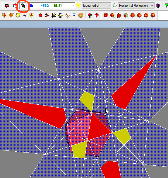

You can already interact with the stellation diagram and the cell diagram. Watch the bottom right corner for tips about what the mouse can do, and hold down Shift or Ctrl to see how they change.
With the mouse in the Stellation Diagram view, hold Shift:
Or hold Ctrl:
You can also display the stellation diagram attached to a selected face of the polyhedron, and still interact with it in the same way:

robertw wrote: Mon Oct 12, 2020 1:40 pm You can already interact with the stellation diagram and the cell diagram. Watch the bottom right corner for tips about what the mouse can do, and hold down Shift or Ctrl to see how they change.
I didn't know about any of this, this is great! You can even use it with faceting mode, which is what I was specifically thinking of.
