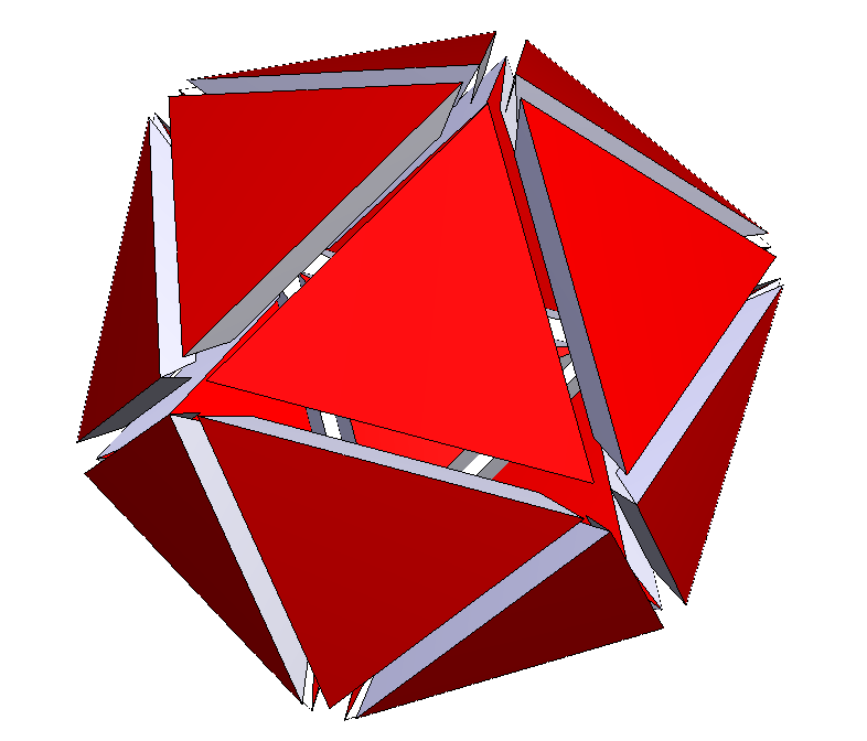

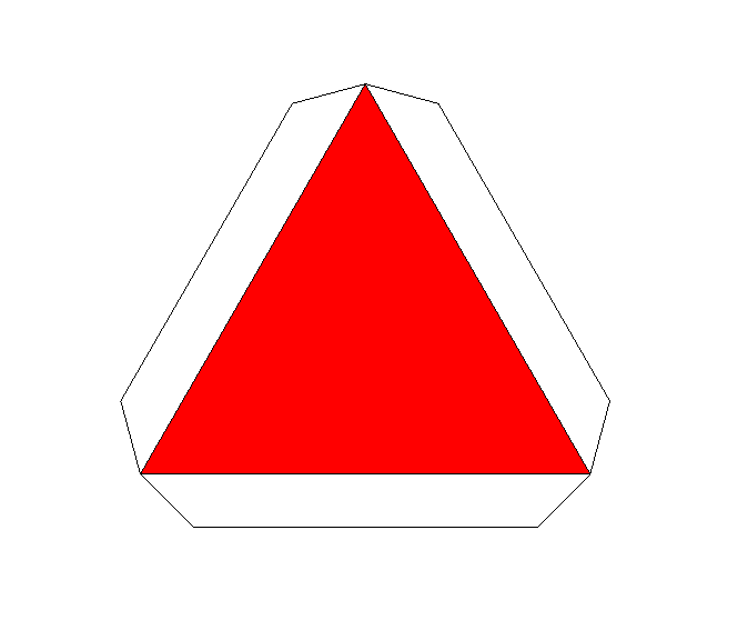

2. Yes, it works, but only with a single net that includes 20 triangles (for an icosahedron). But I wrote you about net that include only one triangle:
Which would take 20 pieces. It may seem to you that gluing 1 triangle is useless and complicates the work, but without this, some ribs are very easy to press in, because they are not glued with glue. And, with these scans, it will not be possible to make a polyhedron with the method of one tabs:
Most likely, Stella understands that a polyhedron consists of 1 type of faces (with icosahedral symmetry), and creates one type of net (triangle), which is actually logical. But in some cases it will be impossible to place tabs so that the polyhedron does not completely contain double tabs, so this is what happens. But it's strange that in the icosahedron and other deltahedra, tabs are created around the entire perimeter of the triangles.

Because one type of nets is created. Stella needs to learn how to make several identical types of nets with the same type of faces, because otherwise it will be impossible to make a polyhedron correctly. (For a triakistetrahedron: if you create a tab on the long side of an isosceles triangle, these edges will be glued by the double tabs method. And if you do not create a tab on this edge, it will be simply impossible to glue the polyhedron in these places).

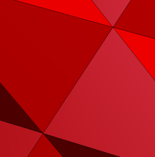

Explanation of the phrase: “partially with polyhedrons, for which this method would cause the tabs to bend inward”: The fact is that with the correct placement of tabs in the Kepler-Poinsot solids in these places: (the photo shows a small stellated dodecahedron)
The tabs should be bent inward (that is, under the face as they should), but Stella creates double tabs:

Oh OK. Yes there are two cases where it will use double tabs even if the overall setting is for single tabs.
(1) If there are multiple nets of the same type, it will use the same tabs on each. So if two such nets meet at an edge of the same type, it will have to put a tab on both of them. The alternative is a different arrangement of tabs on each net of the same type, which could be confusing to put together. You'd need to be careful about which exact net glues to which net, even for nets of the same type. But if you really only want single tabs, you can drop the symmetry to No Symmetry, making every face a different type. Then there'll be no double tabs.
(2) For concave edges I don't think it's every a good idea to use a single tab. The tab would have to fold up rather than down and it's just harder to construct I think. If you really want you can select an edge in the net and set just that edge to the single tab method (probably after dropping the whole thing to No Symmetry). Is this something you personally want though, or more a hypothetical?
