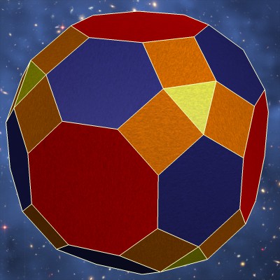

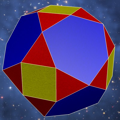

From Stella's near miss library, these two don't need any further variation. I even named them "Equal-edged Near Miss", so that's more equilaterals that were known before that paper. These were ones I found, as convex hulls of new Stewart Toroids.
Image Image

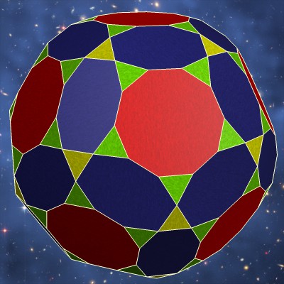

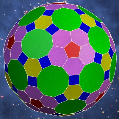

Other near misses in Stella's library can be adjusted for equal edge lengths, such as these near misses discovered by Robert Austin:
Image Image

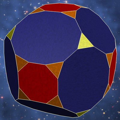

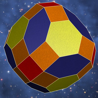

Here's a bunch more. These are all convex hulls of new Stewart toroids that were discovered by Alex Doskey and myself, and which are all available in Stella. No adjustment required as the edges are already the same length due to the nature of Stewart toroids.
Image Image Image Image Image Image Image
