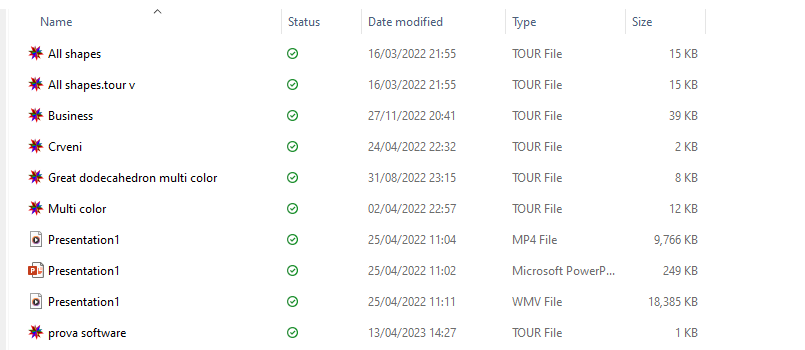

Hi Robert and thanks for fast reply.
It does with all tours. Extension seems ok, have a look at the screenshoot.

The screenshot doesn't tell me much.
